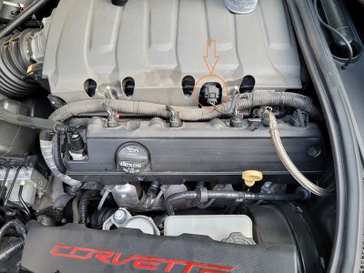

I cleaned the MAF Sunday night but I didn't go for a drive, I didn't want to get stuck at a red light. I took a piece of trim out to see if I had a MAP and pretty sure there's one. It was way too hot too proceed in the driveway it was 40C including humidex I was drenched after 15 minutes. This afternoon or evening I'll take out my powerful fan outside and remove more trim pieces to check if I actually have a MAP.
Maybe I should buy a MAF locally to make sure.

The codes seems to refer to the MAP sensor, A MAP sensor (Manifold Absolute Pressure) measures the pressure in the intake manifold, while a MAF sensor (Mass Air Flow) measures the mass of air entering the engine.
