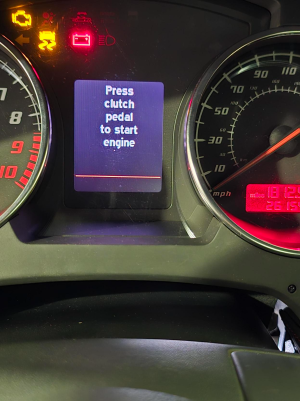

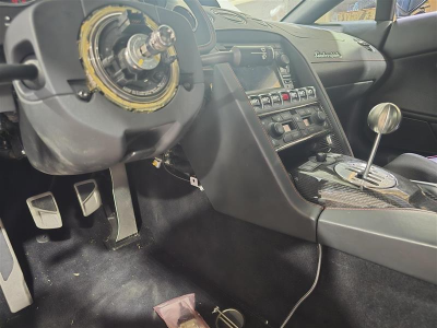

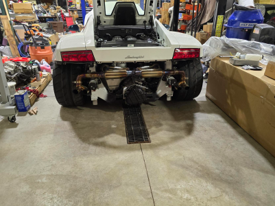

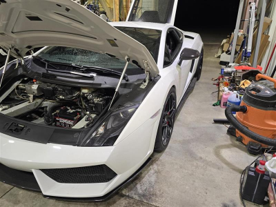

Well....this started as a 'simple' egear to gated swap.
Once I dug into it, I ended up needing to repair most (not all are listed)
-Most bolt on frame components on pass side front
-front bumper core
-Front fascia
-both headlights
-wiper cowel
-pass frunk trim
-pass front upper and lower A-arm
-pass front knuckle
-pass front caliper
-pass front fender liner
-pass rear frame component (cut and weld
-pass rear axle
-both taillights
-all hubs and bearings
-upgraded to stainless brake lines
-rear fascia skeleton
-brake rotors and pads
Lots of crazy stuff. FIred right up when it was all together. Have to recode a few things from the swap, and something is up with the brakes, they work, but I think one of the new pad sensors is snagged.

The hubs/bearings/rotors/pads/stainless lines were a 'well, since I have this all torn down......' sorta thing.
The gallardo (and maybe other Lambos) can be coded with a little handheld called rosstech. I don't know about the serivce oil or clutch resets though. This allowed me to go in and chance the ECU codes to Manual. https://www.ross-tech.com/vcds/hex-net.php
Looking good Bob! Man that is quite a list, what the hell happend? Sounds like you have everything sorted now though, I can imagine that first drive banging those gears will feel pretty rewarding!
I bought the car knowing I would do a manual swap, it was part of the ultimate plan (I had actually bought some swap parts before I bought the car). But, I'm also a poor, so the only way I was going to get into an LP was to buy a salvage or high mileage car. This one seemed to have little damage and was repaired well (from what I could see). Upon tearing into it, I was very wrong.

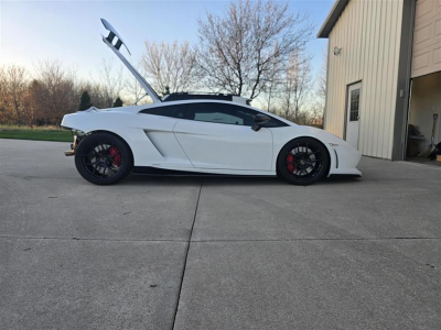

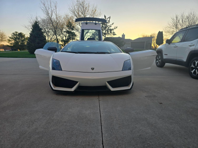

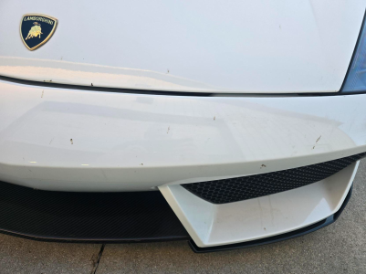

Finally stopped raining here. Took the G for a backroad spin in all it's bumperless glory.
Only went about 4 or 5 miles, cruised decent at 90mph. Desperately needs an alignment (scheduled for next Tuesday).
Managed to kill a bunch of bugs.
905
That is one huge garage and awesome driveway! Lots of space and spotless too.
The G looks great too, especially with its weight reduction mod :)
