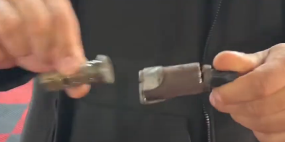

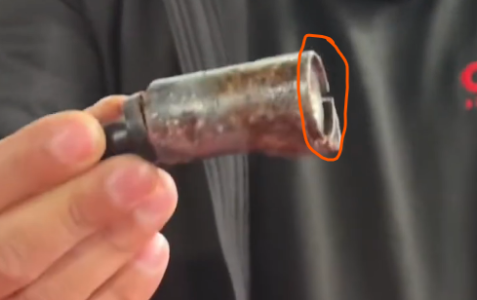

In the UK looks like many people leave their sports cars parked in the driveway and drive in the rain. Here's an example what happens, look at the rust and corrosion, both of his broke while removing them! You can see in the 2nd picture how fragile the crimp is holding both pieces together.
