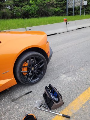

Flat tire or broke down and need to have your car towed and your damn manual is at home?
Try to park somewhere safe for you and the truck driver. Stuck on the highway without a shoulder or somewhere it can be dangerous, call the police so they can close the road so the tow truck can pick the car up.

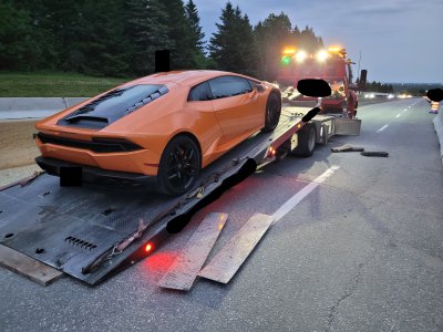

When safe and while waiting for the tow truck to arrive here's a quick break down. Make sure to tell them you have a sports car and to bring pieces of wood to climb the truck flat bed. If your car is running and driving it's easier to just drive up the bed and you won't need the tow hook. ( I didn't need the took hook after all)

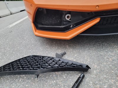

Put your nose lift up

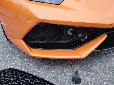

Put your fingers through the the right side grill and pull outward to expose the tow hook receptacle,
Pull out the the tow hook plug
Retrieve the tow hook from the left saddle bag in the frunk
Screw it by hand all the way and it possible use some bar to screw it some more.

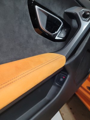

Press the alarm off button in the driver's side door(Inside the pocket)

Once on the bed put the car in park and activate the parking brake
I'll post how to put the car in neutral some time later if the car doesn't start.
